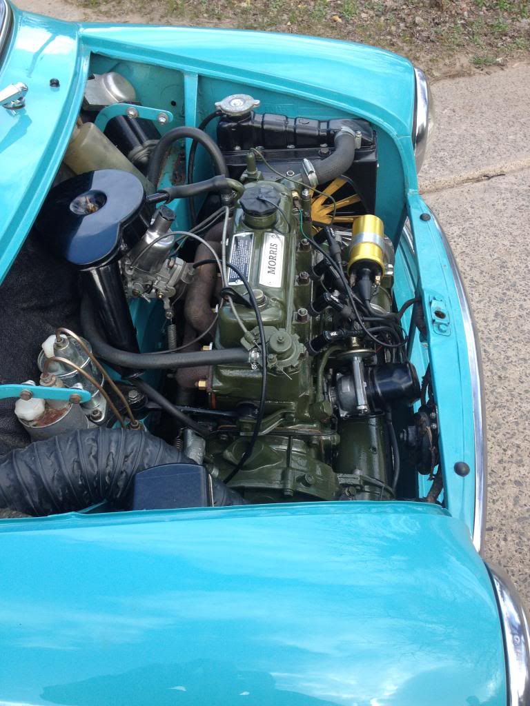

Rebuilt my standard 850 engine (with coil spring flywheel)
Despite fitting a new clutch primary gear oil seal it failed on starting up and leaked :cry:
I have now stripped the flywheel off and ready to fit another new one.
I have ordered 13H2934 from Bullmotif which I understand fits all models 59 - 92 however I see they also suggest GHS101 for early coil spring cars, so Ive ordered both.
Has anybody any experience of which I should use for this car?
(Apart from the seal failing Im happy with how it all looks)

Very nice looking car / resto by the way, yes, you should be very happy with that.
Usually when the seals tear, it's from having no lube on the lip, they do need a smear of something.
captain
Posts: 263
Joined: Mon Jun 20, 2011 10:25 pm
Location: dumfries
Re: Early clutch oil seal
Post by captain »
car looks good well done :D
