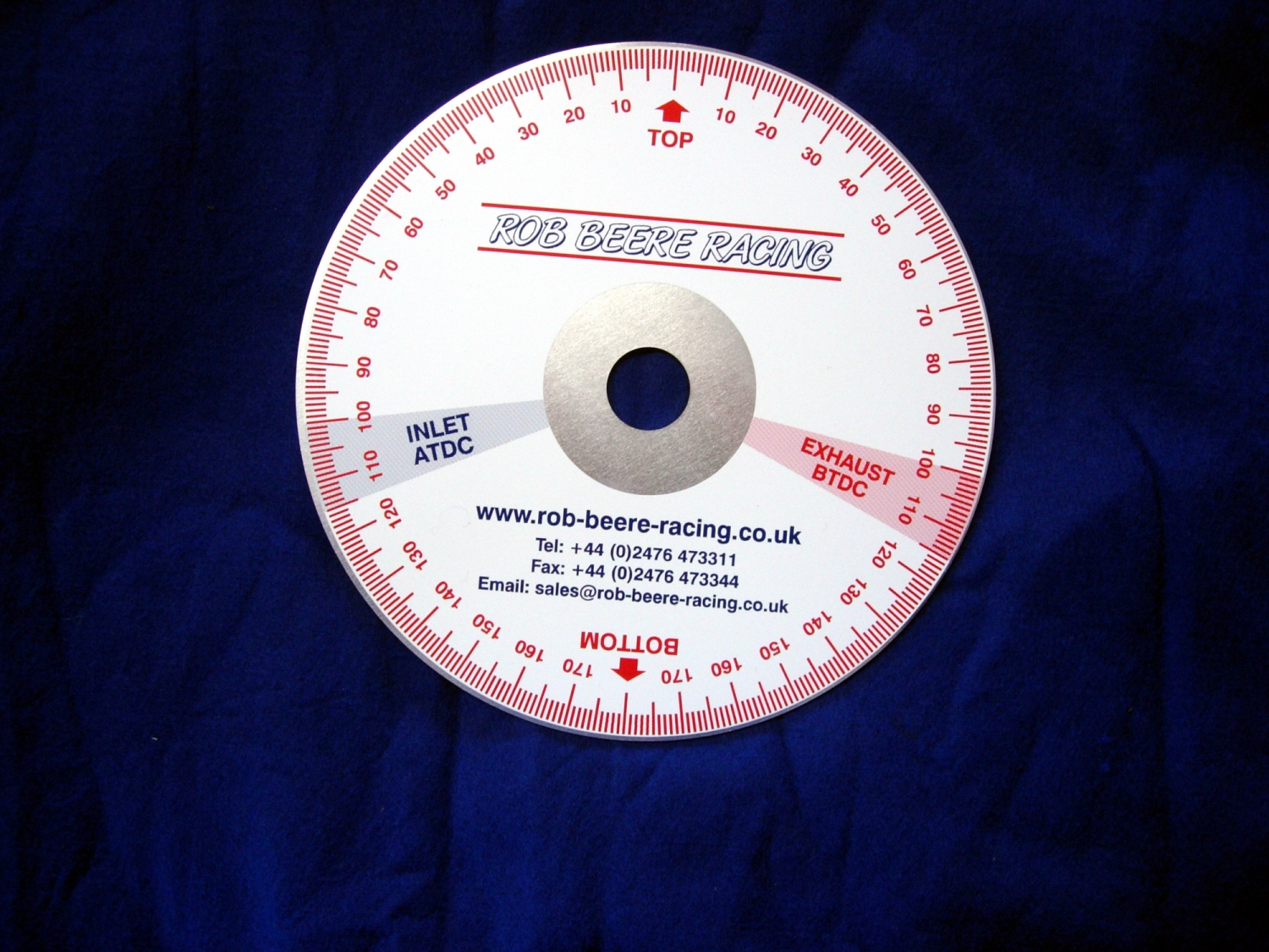

If you are referring to - have inlet: opening 112 after and need: opening 110 after, then you need to advance the cam.
http://www.rob-beere-racing.co.uk/pictu ... ngdisc.jpg
So actually we are in agreement.
