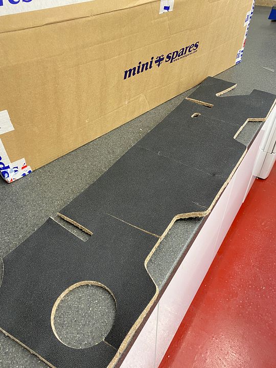

Thanks for the replies so far.
I decided to purchase the Mini Spares bulkhead soundproofing felt, which was at least cut to size and patterned to fit the MK1/2 Minis. I assumed when it got here it would be just the actual felt and I would have to source a piece of Hardura material to make it look factory.
I opened the box today and this is how it looks..
Well chuffed with this, looks (as far as i can see) to be exactly the same as the factory finish.
Just thought i'd share this incase anyone else needs to source one in the future.
I'll get some pics up in the project thread when i've fitted it.
Matt
Matt

Re: Mk2 Original Spec bulkhead soundproofing pad
Very tidy. looks good
Can you buy the mat without cuts or hole's from mini spares or their supplier?
