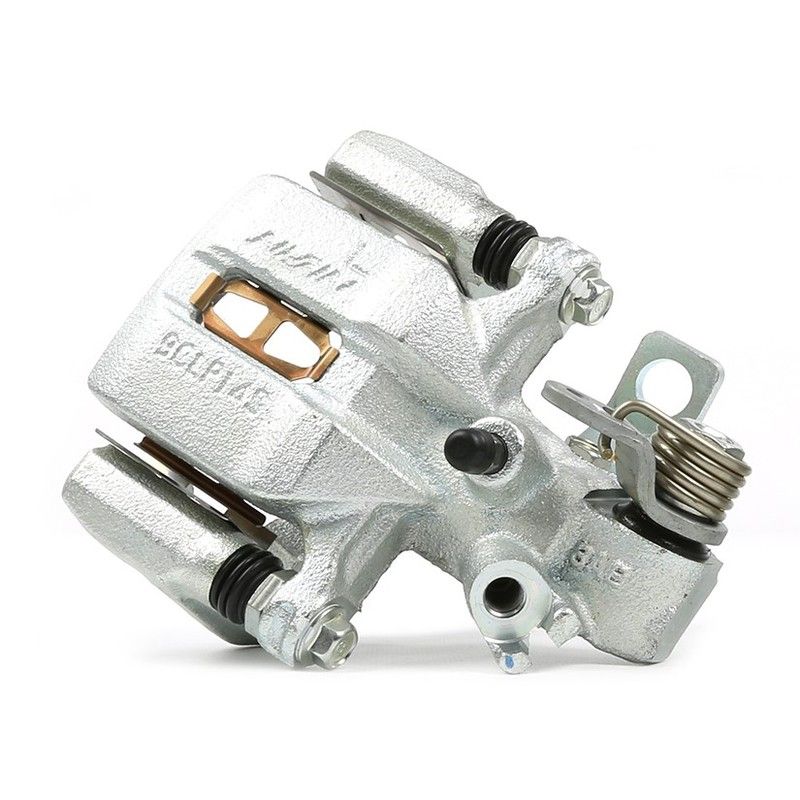

There are calipers available with a mechanical link that pushes onto the caliper mechanism but whether they would fit under a 10" wheel is debatable.
An alternative is to mount a separate caliper onto the disc and use that for parking if a disc is used.

I'd suggest fitting Discs (I wouldn't even look at Drums), have a look at Rear Calipers from the likes of Honda and Toyota, though you need to be mindful of Brake Balance, but that's not at all insurmountable.
I've done a number of Rear Disc Conversions, mainly to get lower maintenance Brakes and a decent Handbrake, though, those I have done have been for bigger than 10" wheels, but I'm sure you could get one of those calipers I've mentioned in there. These have both Hydraulic for the foot pedal bit and mechanical for the handbrake bit and they auto adjust, as Discs normally would. Note that with any floating caliper, you'll need to use sheathed handbrake cables. Open ones will only make the caliper jam on the slides and likely damage them in time.

I dont see the need for an integrated caliper, there are plenty of mechanical brake calipers out there from Go Karts, aircraft, ride on lawn mowers it would be far easier to mount a small caliper opposite the hydraulic caliper and cable operate that.........Just my personal opinion though. Me I would just keep the drums unless I was going to race it, I can't see you breaking the CV as has been said there's no turning movement for them to cope with.

This is the Honda Calliper I mentioned earlier
One Calliper, two bolts to fit up, has Hydraulic for the foot brake and Mechanical for the hand brake. Done a few with these.
