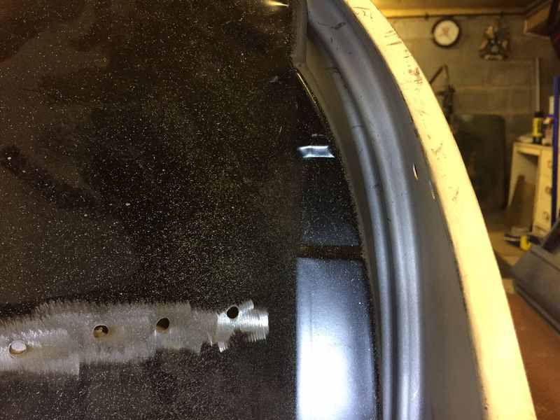

I need a little advice regards inner wing fitting on my mk2, I was expecting the return lip on rear of the heritage wings to be spot welded to the outer a panel inside the door jam, I have fitted the wing correctly and it lines up everywhere else but it is a good 20mm away from the place I wanted to spot weld it to, I really can't see anything wrong with any of the panel fit so am at a loss what to do, anyone have any advice regards this issue,
Failing cutting off the return lip and welding a new one on I can't see how it could be done.

Thanks
Please see pics below,
It fits fine on bulkhead, under floor and at bottom, it's just the top of door post, other than cutting it I can't see a way around it as it's so far off the a panel is correct as door fits fine,
I really don't think it will clamp over without causing issues elsewhere

Wow , that's out a fair bit
I take it the outer A Panel all lines up ok with the door fitted and sitting flush ( A to Door skin )
Maybe its the Pressing that's wrong . I know i had some issues again on the N/S on my MK2 . ( It was more at the bottom )

with everything you have said it all seems ok and correct . And the amount of gap you have 20mm on the inner wing area , if there was an error it would stand out a mile . Maybe its just a very bad pressed Inner wing ??

My friend had the same problem with his van.
He slit the inner wing, "bashed" it out to meet the A post and then welded in a strip to "fill" the gap.
He wasn't a particularly happy bunny with Heritage.

I also trial fitted inner a panel and it also slots in ok and lines up with holes on outer panel and also scuttle closer is in correct position, also lines up fine at bottom, think I was exaggerating with 20mm think it's about 13-15mm out at top,

Hi Daz. I know your pain. I have just done this and it's a pig of a job. I used m-machine inner wing repairs and had the same problem. Profile is not good. In the end I removed the inner A post stiffener(with the check strap captives on) so I could clamp it all together with some force. I then spot welded and replaced the stiffener with a new part which, guess what, didn't fit very well either. Both the inner wing and stiffener needed plenty of bashing with a hammer first. Fits great now and is super strong, but took patience. From your picture I'd suggest pushing it up a bit and bending in the very top zig-zaggy bit if it snags. If it means chopping metal off the top or adding it to the bottom, or having to remould the lip at the bottom around the toe board/floor, then that's just the way it is. Good luck.

I can't really move the inner wing up as it is aligned level to other side and shock absorber mounts, will clean up the hinges and fit the door properly check everything over then if I need to slit the flange off inner wing and move it to the a post then make a template for a piece to let in the inner wing, it's only clamped on so I can remove it and weld it up then try the fit again, just glad others have had problems in this area as it's a critical part in getting the front aligned correctly and I want it right. I currently have no inner post as I have cut it out and have a new one to fit after the spotwelds are done.

Yes I see how you can't move it up as its a complete inner wing, mine was just the repair. You'll just have to force it, maybe bend out/bash or joggle the top section to approx the right profile, then clamp from the inside to the A pillar outer shoulder, spot weld, then move down. As long as the A panel inner fits it will be ok. Anyway, it's happened to a few people by the sound of it so just one of those joys of restoring a mini. I ended up using 2 panels as I had to 'encourage' the first one so much! Still got the other side to do.
