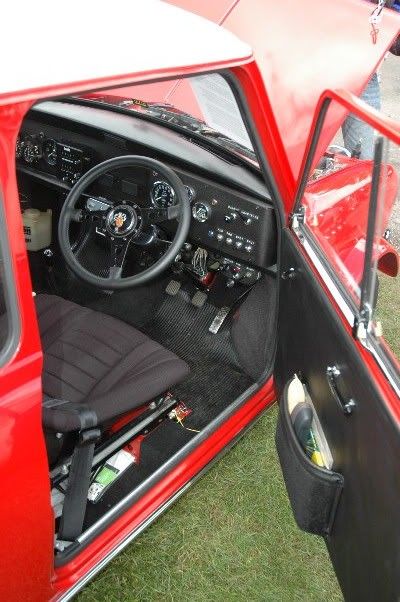

Probabaly not quite what you're after, but I'm sure you'll be interested in these pics of ST 998 Clubman SOH 886H

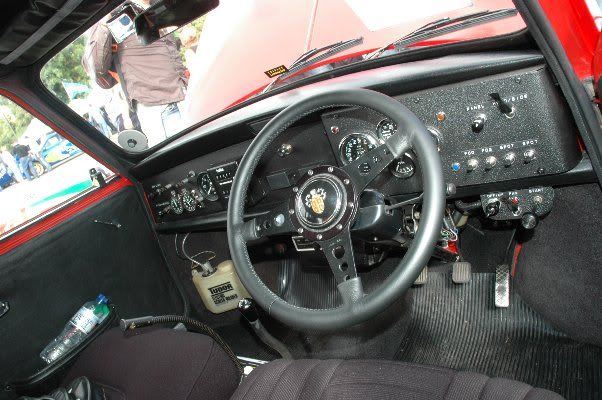

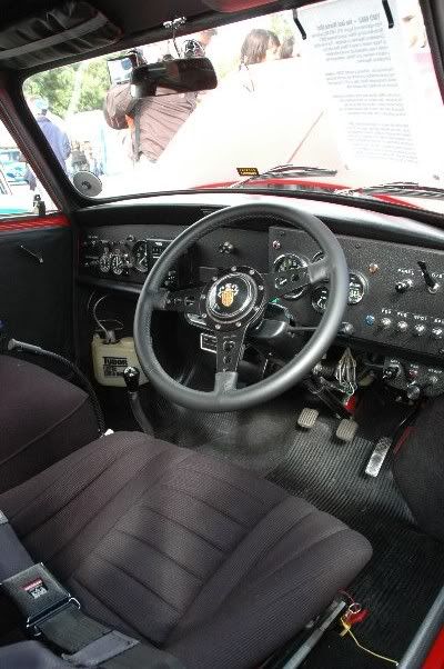

A few more

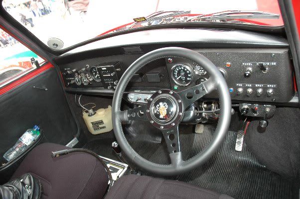

More recently...

Thanks Guys , that's what I am after , love SOH 886H that must be some serious fun , what kind of spec is the 998 engine/box .

I'm not sure of the spec. as pictured for the 1970 Alpine rally, but the current owner ( Dave Beswick ) advised me that a later spec. while still in BL ownership was std 998 bore and stroke, flat top ( Miglia ) pistons, 649 cam, 12g940 Downton head with block pocketed to suit, twin HS 4's. I believe the car was used to promote some of the Special Tuning parts that were available over the counter from BL dealers at the time.irlmin wrote:Thanks Guys , that's what I am after , love SOH 886H that must be some serious fun , what kind of spec is the 998 engine/box .

That car looks fantastic.
Interesting that it's badged as a clubman, has a 998cc engine, (albeit modified by ST), and has 1275GT clocks.
Do like the addition of the works dash panels as well.
