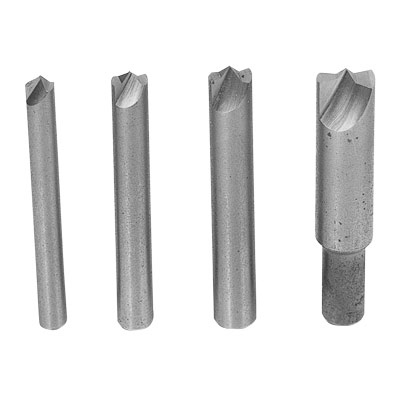

Don't worry about drilling them out. If you use a spot weld cutter/drill, it does not go through the top panel. They cut (or saw) away the perimeter of the spot weld leaving a "disk" of metal behind on the panel that is not removed. You use a disk grinder with flap wheel to dress those spots down flush.
Yes, it takes a while to cut through all the spot welds and dress them flat but there are not holes through both panels when done.
Saw type spot weld cutter:
Spotface type spot weld cutter:

Doug, thank you for the pictures of various spot weld cutters.
