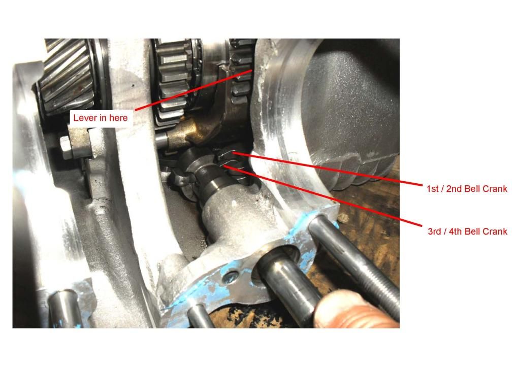

you can do it but its an utter git to lock a rod change into 1st and 4th, its easy on a remote as the fork rods are accessible (but take the two detent plunger cover bolts out first to make it easier to manipulate the forks)

Mmmm,,, rubbish. It's easy enough, though fair enough, it's easier on a remote box.rich@minispares.com wrote:you can do it but its an utter git to lock a rod change into 1st and 4th

not if you have massive hands like me it isntSpider wrote:Mmmm,,, rubbish. It's easy enough, though fair enough, it's easier on a remote box.rich@minispares.com wrote:you can do it but its an utter git to lock a rod change into 1st and 4th
I have a bent screwdriver for hooking/pushing the 3rd/4th hub across, which does help!

Yeah, that's pretty much how I do them, on the shift bell crankrich@minispares.com wrote:
Push the 3rd / 4th crank IN, then lever the 1st / 2nd hub across, sometime need to rock the gears a little to get that one on.
But, that's all academic, as the OP has a remote.
