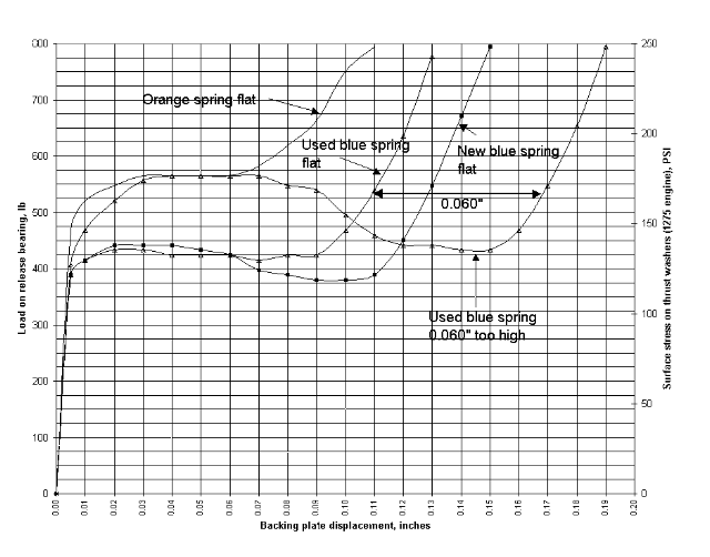

1071 S
Posts: 923
Joined: Sun Jun 27, 2010 8:44 am
Location: Southern Tablelands (Oz)
Re: Clutch drive straps - MiniSpares parts
Post by 1071 S »
http://www.minimania.com/imagesbig/fig8.gif
Go here - this is the raw data that describes the relation ship between clamping pressure and backplate displacement.
Thanks to an enterprising Canadian...
Suffice to say that the difference between a diaphragm as pictured - and one set up flat - is amazing. As is the effect on the life of the current release bearings..
