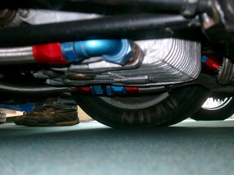

I've never understood how dry sump could work on a Mini. Could someone please explain?

Good valid point, but I've seen American Mini FWD SCCA racers that are dry sumped.

Vegard wrote:I've never understood how dry sump could work on a Mini. Could someone please explain?
a guy in Harrogate used to have a dry sumped 'big' arden race car, I think the dry sumping helped mainly to control the oil temperature and the foaming as there was so much more oil in circulation and so little actually in the gearbox.
he certainly had the results and the performance to back the value of the system up, but I suspect modern oils are probably the better option now

rich@minispares.com wrote:Vegard wrote:I've never understood how dry sump could work on a Mini. Could someone please explain?
But surely, on a Mini you'll need some oil in the dump for the gears??

I think they use and extra oil reservoir :p

In reply to your comment vegard, by a spraybar in the right place!
