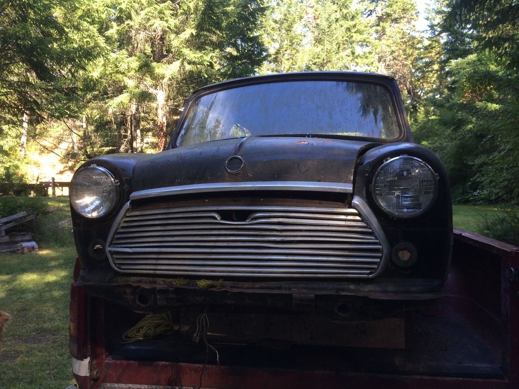

So, I have picked up a rather sad little mini, it is essentially just a shell, no subframes, no engine, no seats... Very rusty, roof squished in...
It is a MkII, and the wiper motor and glass point to it being a 68.
I was looking at the vin, and it is AA2SBD-12187xx
So, what I gather, it is an Austin Deluxe, what would make a car Deluxe compared to a Standard Mini?
Would it be worth the effort to repair? Really, it only needs everything...

Deluxe had the opening rear quarter windows, bright filler inserts (instead of black) in the screen rubbers, overriders and the lower dash rail had that large rubbery moulding which brought the switch panel closer to the driver. Standard Mk2 still had the plain, painted dash rails, rubber mats on the floor and Mk1 style seating along with retaining the "wand" gearstick whereas Deluxe (Super Deluxe?) had carpets, better upholstered seats AND the remote gearchange 8-)
Probably other stuff too.
Is it worth it....... I'd have to leave it to somebody else to answer that. If most of it is missing, that's a lot of bits to buy and a 2nd donor Mini can't be bought for £50 anymore. Personally I like the Mk2. Quite a rare and interesting variant I think.

So, it's really bad... will need an entire floorpan, boot floor, doors and a roof, then all of the regular resto things, inner/outer A panels, you know, everything.
Not sure what to do with the old girl, I have all the subframes and running gear

oohhhhhhhhhhhhhhhhhhhhhhhhh
black and gold.........
tatty..............
speedstripe.................
IM IN!!!!!!!!!!!!!!!!!!!!!!!!!!!!!!!!!!!!!!!!!!!!!
that ticks every box!
get it restored!
