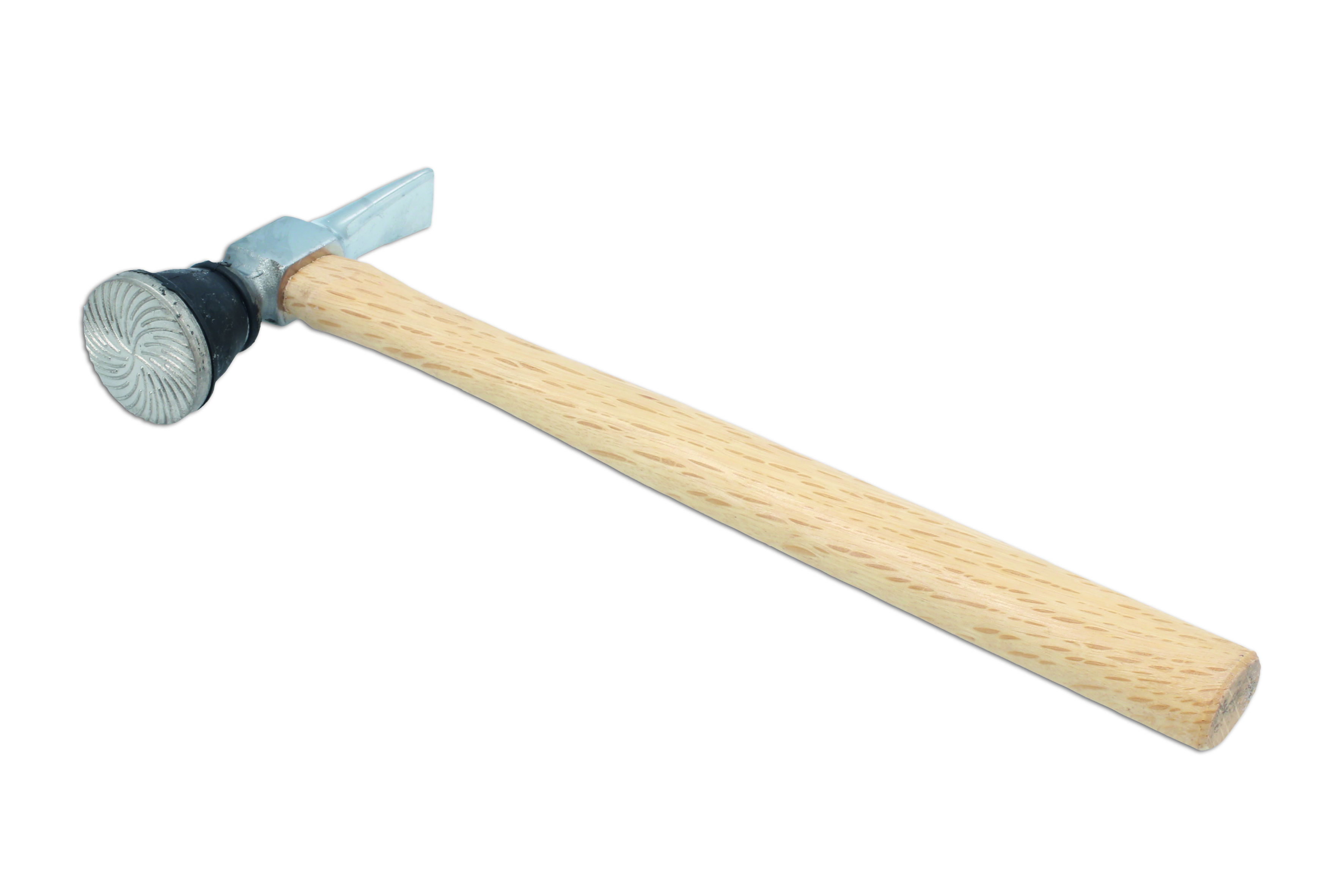

I may insist that "shrinking" the sheet metal is possible. What you need is a shrinking hammer (as in below link or better just a piece of a file welded on an old hammer) and by beating the metal you slightly ripple it - hence it shrinks.
Imagine a piece of string, once you lay it in ripples, the distance between the ends gets shorter. Easy peasy...
https://www.ebay.co.uk/itm/164500934124 ... 1506.m1851
https://images.esellerpro.com/2613/I/14 ... 6_Left.jpg
But I have yet not modified a scuttle panel in such a manner, my suggestion clearly is dolly and shrinking hammer

Agreed, We have both Shrinking hammers & a shrinker/stretcher in the workshop.
Shrinking Hammer
https://www.zoro.co.uk/shop/automotive/ ... lMQAvD_BwE
Shrinker / Stretcher
https://www.expondo.co.uk/msw-shrinker- ... DEQAvD_BwE
Needless to say, the most expensive works best.
Shrinking Hammer

As a side note I wouldn’t recommend the use of a shrinking hammer for this job or really any other. They can work for removing “oil canning” from large panels by basically adding large quantities of small dents to take up slack in the metal but they are more marketing than anything else.
