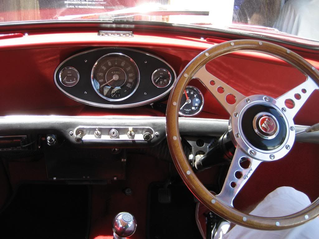

As a rule of thumb, anytime I work on anything to do with the steering I make sure the wheels/tires and steering wheel are straight, pointing forward.
The brass color I need to get to is in-between the steering wheel boss and the turn signal housing. You can barely see it in this pic.

Nicely done sir ! I notice also that your speedo is from a very early 997 Cooper.
Nick

nick rogers wrote:Nicely done sir ! I notice also that your speedo is from a very early 997 Cooper.
Nick
Thanks Nick. Yea, I ended up distroying the original 90 mph speedo after trying to rebuild it. But I was lucky enough to be able to replace it with this cooper speedo.
